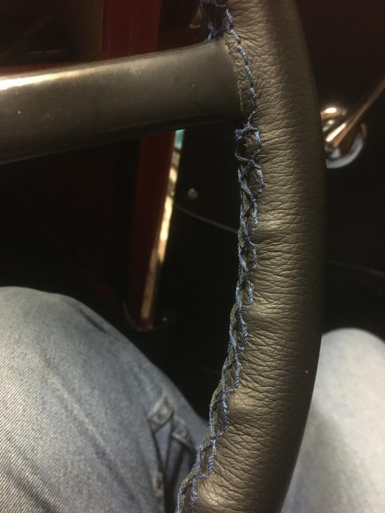

Hi Ruairidh
Have you considered the leather steering wheel cover available on eBay. I fitted one to my RN wheel and am very pleased with the result, it's very comfortable and looks 'proper'
Regards
Barry Townsend

RE: Stringing steering wheels... - Barry Townsend - 22-11-2020
  Hi Ruairidh
I've taken a picture of the cover if it's of any interest
Just type in Austin 7 steering wheel cover in the search box and it will come up straight away
