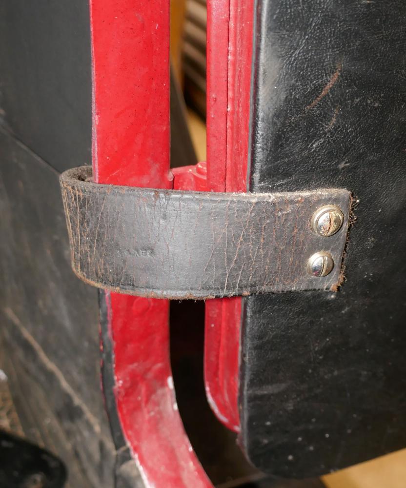

These are not, of course original, but one shows a very neat arrangement and the other how the strap is bolted to the frame (in this case by Bodger No.1) in a more workaday solution.

Arrrhh, that's rude... (the last!)
