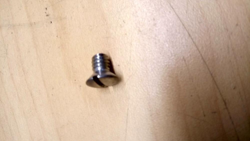

RE: Dash screws - David.H - 06-08-2020
I still have the scars from holding the nuts behind the panel and my hand jammed between the scuttle tank and the dash (27 AD)
I tried the blob of grease on a finger, but it was the hottest day of the year.....I was using 1/4 BSW r/csk slotted as in the picture ....and solved the problem with  wing nuts that I could hold in place with Mole grips on the wing!  Some form of captive nut is,of course,  the answer, but not for the stoopid owner trying to be "original".and ening up blooded and compromised anyway!!!
David
