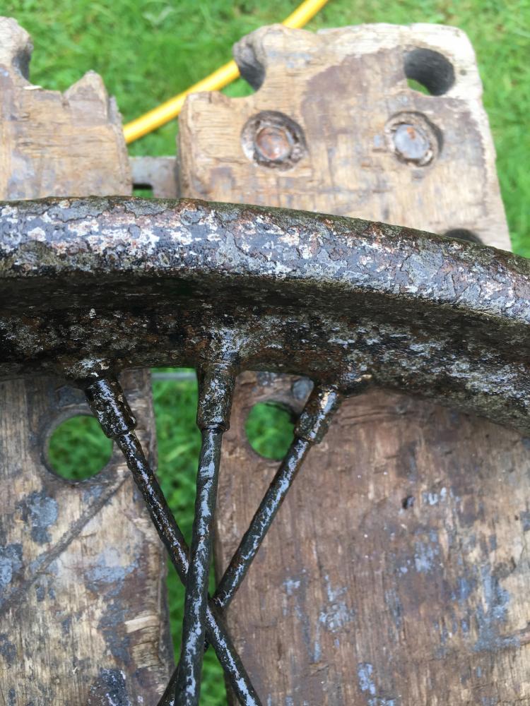

Molasses rust removing on a wheel - Howard Wright - 15-09-2019 Hi All On my Brookfields Special thread I mentioned that I was trying out molasses as a method of rust removal. Jamie asked to be kept up to date so I thought a new thread may be a good idea. I've posted some pics below. The wheels were quite rusty when I got them so I did spend some time wire brushing and removing as much of the rust scale as I could. The molasses was bought from a farm supplier and is used to feed horses (5 litres cost £8) I also bought a huge rubber bucket over 20" in diameter. I mixed the molasses 9 to 1 with water, dunked two wheels in and covered them with boards to stop vermin getting in. They were under cover and outside. Firstly molasses smells especially once it starts to ferment and it develops a yucky mouldy crust so this method is not for the feint hearted! I pulled a wheel out today, just two weeks since it went in, and I was quite pleasantly surprised. After a good hose down and another wire brush the wheel looks pretty much rust free. The molasses won't take off paint though. I dried the wheel with a hot air gun but within a 1/2 hour or so surface rust had already begun to develop so I gave the wheel a coat of primer (I had to brush paint as SWMBO won't let me use power tools on a Sunday so no compressor for spraying) Hope this is of interest to others contemplating molasses rust removal? Cheers Howard RE: Molasses rust removing on a wheel - JonE - 15-09-2019 Howard - what is the process - does it make acid during the fermentation? RE: Molasses rust removing on a wheel - andrew34ruby - 15-09-2019 Your finished primed finish looks rather rough, and it's not easy to wet flat a wheel to get a smooth finish. So my question has to be -- why not blast? Mine were abrasive blasted and after 2 coats of epoxy primer and 2 or 3 coats of 2 pack gloss the finish is good with no sanding. My photo is of the blasted bare steel, though it looks like grey primer. RE: Molasses rust removing on a wheel - Howard Wright - 15-09-2019 Hi Jon and Andrew Jon I think molasses contains a chemical (chelating agents) that dissolve metal oxides. Apparently it is recommended to take loads after a nuclear bomb as it removes the nasty radioactive stuff. Well that's what I read! Andrew Because I'm a cheapskate and can't (didn't want) to spend that much money. I did have my chassis, axles, hubs etc sand blasted and it worked well but at a cost. On heavily rusted parts you still get a rough finish. The rough finish in the photo is when the wheel had just been removed from the molasses. After a wash and wire brush its much smoother (zoom up on the full wheel picture). I've also read that some of the sand particles could get in the spoke holes and cause wear but I'm not sure this is really a problem. I did price up sand blast and powder coat for the wheels but that was £70+ a wheel. Cheers Howard RE: Molasses rust removing on a wheel - Duncan Grimmond - 15-09-2019 Crikey, I've just had four(4) wheels blasted and powder coated for £76.00. Admittedly they had new rims and spokes which made for less work. I hope your wheels run true. Looking at the state of the spokes and rims I'd guess the nipples would be seized making it impossible to true them up? RE: Molasses rust removing on a wheel - Howard Wright - 15-09-2019 Hi Duncan I don't think it would be a good idea to try touching these spokes and the rims aren't silky smooth so that's the reason I'm not shelling out on blasting. To be fair the wheels are serviceable as long as they run true and a preliminary spin on the axle suggests they're OK. Cheers Howard PS Let me know who did your wheels as they sound very reasonable and possibly worth a trip north! RE: Molasses rust removing on a wheel - Bob Culver - 15-09-2019 Many sources are sceptical about blasting panels but maybe the thick hard steel of Sevens is better. Is there a tendency to stretch and loosen the spokes? With a relatively inexpensive home treatment and final finish, if after a bit of running the spokes work free in the rust and become slack not a lot is lost. Are replacement spokes dual gauge as the originals or same thickness throughout (which looks clumsy)? In my experience the original spokes are very robust, even when rust pitted. Are new nipples with the exact original cycle thread available? Does anyone make a dinkum die or die nut (not just close NF!) RE: Molasses rust removing on a wheel - Ian Williams - 15-09-2019 I have used Molasses quite a lot in the past, it is effective but slow, another month or two and Howard's wheel would have come up clean. I found it is good to remove as much rust as possible manually to speed the process, the down side is that as the Molasses ferments it smells rather unpleasant! RE: Molasses rust removing on a wheel - JonE - 15-09-2019 I was really surprised that even on really grungy spokes, a little heat from a kitchen flambe gas torch freed them relatively easily. RE: Molasses rust removing on a wheel - Tony Press - 16-09-2019 What about the chance of water getting into the hollow rim when submerged ? |
