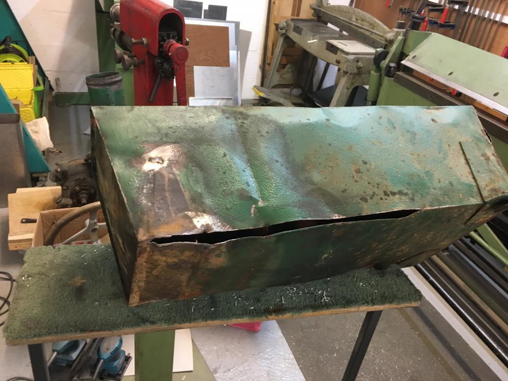

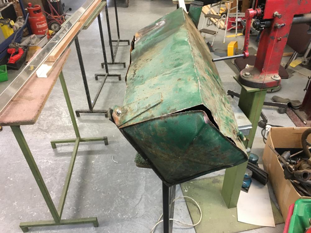

A while ago there was a thread regarding petrol tank repairs. This one came to me on Tuesday. I'd seen the car on drive it day and offered to repair the leak which the owner found on filling the tank above half-way.
He mentioned he was a foreman mechanic so I thought he'd know what he was doing and didn't raise the topic again...
Very lucky not to be wearing it!

Holy moo... I presume that's what happened when he put a torch to it?

He's very lucky if he wasn't seriously hurt when that went bang. A friend of mine had a fuel tank go out through the wall of his asbestos garage when he was brazing up a pinhole in a tank he thought was clean.
The couple of times I've worked on old fuel tanks I've always steamed them out before filling them with water to just below the repair area. Even after gingerly poking the lit torch down the filler hole before starting work I've not found them a relaxing thing to be mending.

May I use one of your photos Duncan to send to the PWA7 magazine as a warning on what not do. I always remember a talk on tuning Seven engines which started off by explaining that pound for pound petrol is more explosive than dynamite.
RE: Petrol tank repair - Roland Alcock - 11-05-2019
I also would like to use the photos on the HA7C newsletter if that’s ok please.

Roland & Dave, sure, use the photos. I hope they serve as a warning.
