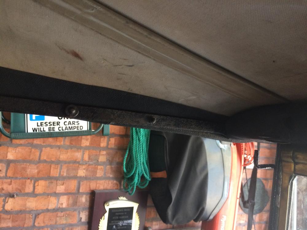

I have found a small "lift a dot" on the inside of the hoodframe (just visible in the hood underside picture, and obvious in the external one. The rear hood frame rest also had a 3/16" hole that takes a lift a dot. Can anyone tell me if the these fasteners are supposed to take a strap to hold the frame down when folded? If so does anyone make them, or is it a DIY job? What should it look like? Are there any other straps to restrain the folded hood & frame?

David I would say the LAD in the hood frame is to hold the top forward edge of the rear sidecurtain. The other LAD in the hood rest is almost certainly for a retaining strap.  cheers  Russell

The one on the hood rest is in the correct position to hold a hood bag steady.
RE: AG hood & frame - Mike Costigan - 19-04-2019
Both those lift-the-dots are for the hood bag. The hood itself should be strapped down with a leather strap around the folded hood-irons, the hood bag is then fed from the back and the inner and outer parts of the front of the bag are held by the fasteners.

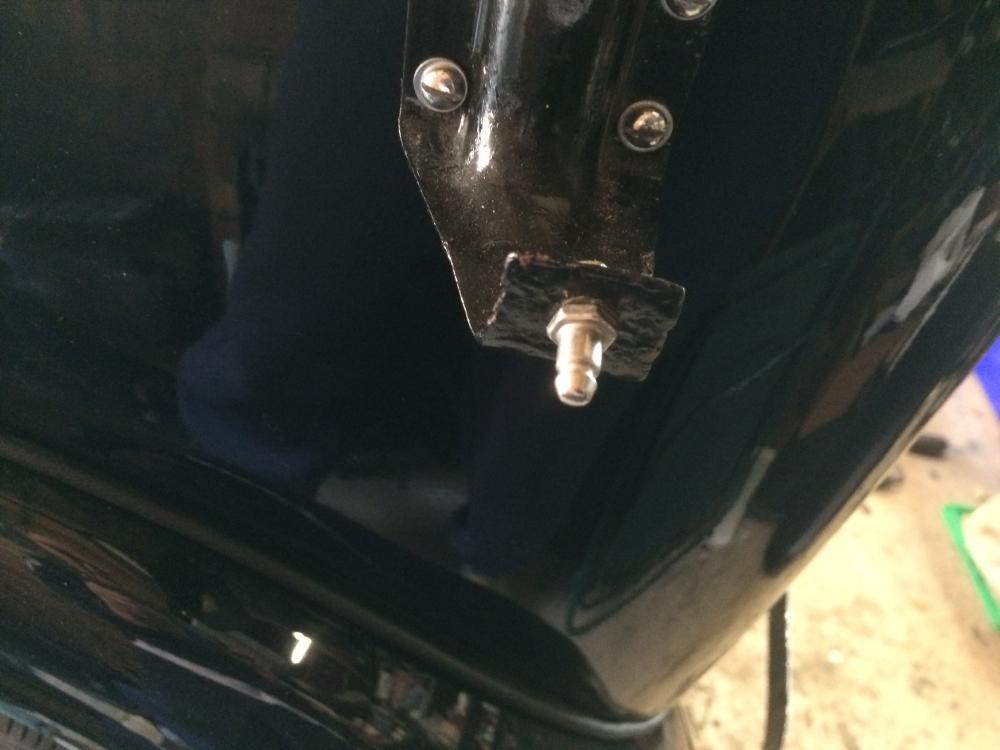

My AE has a gurt lump of rubber mounted on the outside of the pressed hood support bracket that sits on the back of the body (an identical pressing to that shown in the photos above). The hole is used for the fixing. No lift the dot

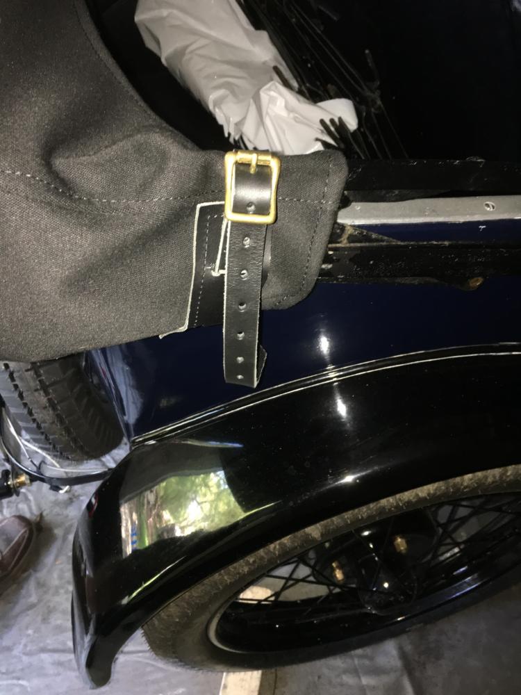

When I made the hood bag on mine I did the straps like this, they need trimming or getting some shorter ones from eBay.  There is a leather patch which the strap threads through, I believe this looks like the picture in the A7 handbook.
