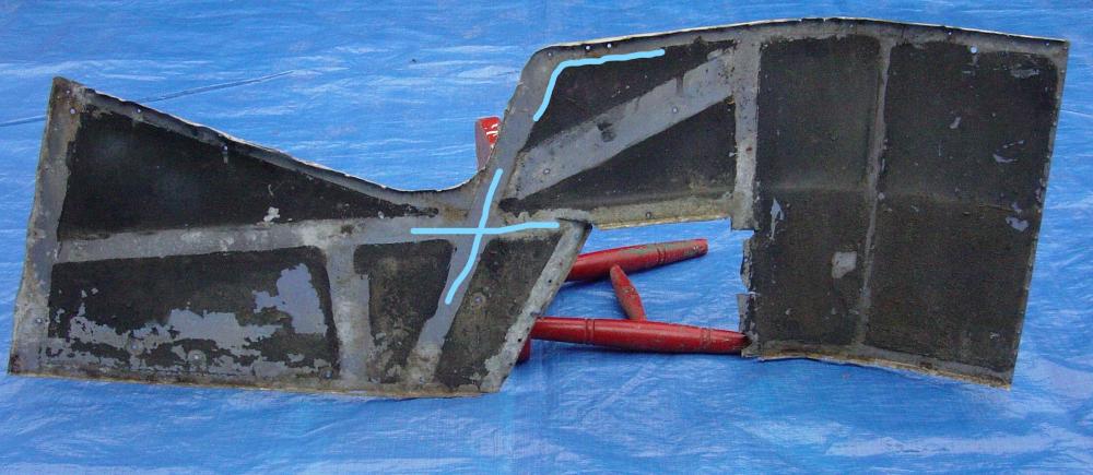

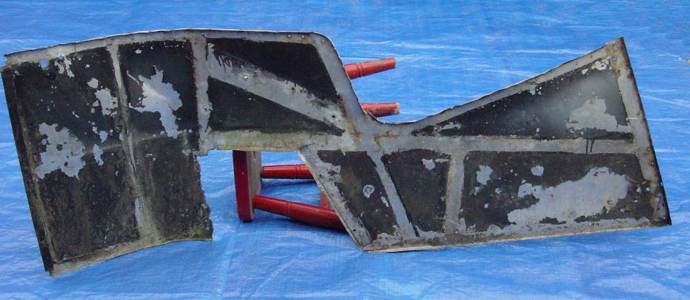

If you are still considering building a Cambridge type Special, these photos may help. They show the inside of the two sides of the body illustrating the position of the ash frame. Also shown are the metal supports used on each side for additional strength. The postions of these supports are shown roughly in light blue on one of the sides.
Bryan
Bryan
Bryan

I have not received an email. The parts that I displayed are no longer in my possession but I am happy to discuss details.
Bryan
