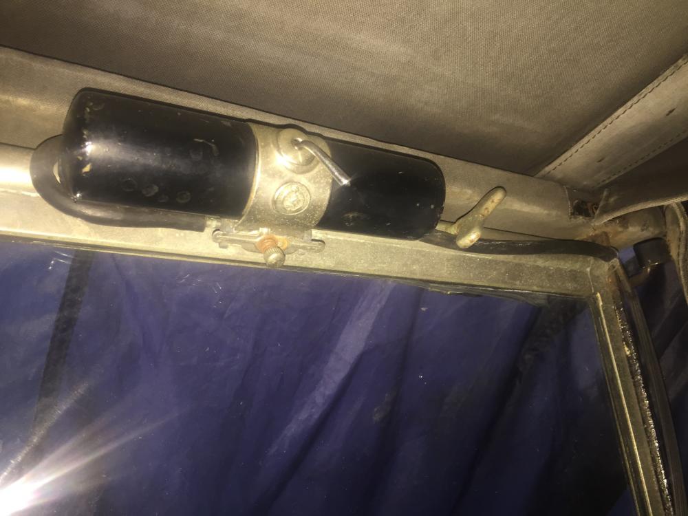

RE: Windscreen Wiper Vacuum tube - Ruairidh Dunford - 05-09-2018
Here’s mine...
