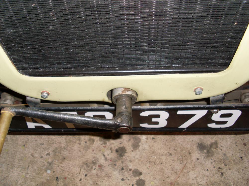

Steve Hainsworth recently gave me a good nose cone with working lugs but it turns out my handle doesn't fit it. It seems like it's been sleeved by someone in the past?
Either that or I am dealing with mismatched parts again. Was trying to explain it to another friend on the phone but pictures might help.
[Image: main.php?g2_view=core.DownloadItem&g2_it...alNumber=2]
