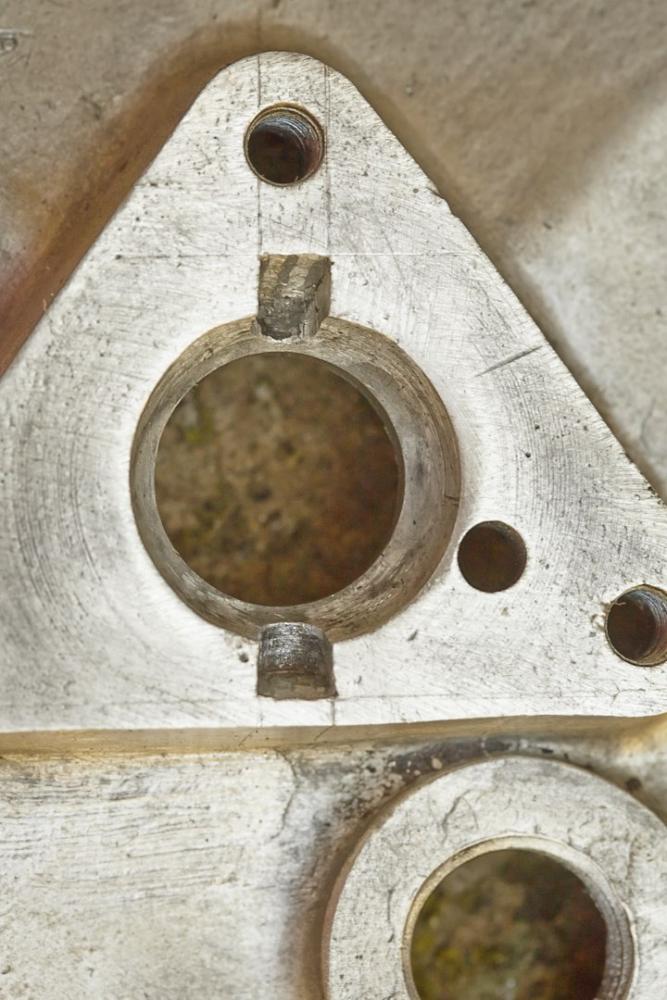

I’m  looking for guidance from those that may already have repaired a worn gearbox gate, from a gate change box, obviously. Attached pictures show both top and bottom groves are “v”d, allowing the ball and lever to slop around.
Any suggestions or advice regarding repair would be appreciated.

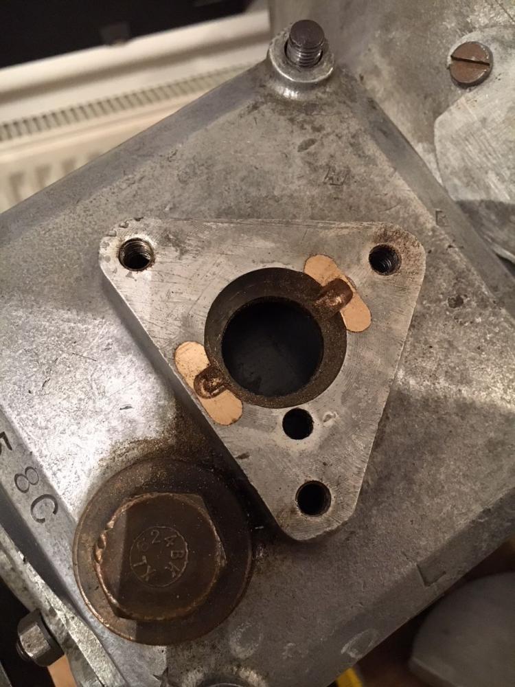

This is work in progress, inserts will be held in place when all is married up.
Regards, Mark.

Presumably you used a round end end mill. but the original seem to have squared ends. How do you reckon those were machined? Or have they just worn to square ends?
Are the inserts semi circular? If not how were the rounded ends prepared?
RE: Gate change gearbox repair - jboy964 - 27-06-2018
Thanks Mark, is this work that you have done yourself, and what material are the inserts machined from please?

Personally I favour welding and machining, here is one I have just done.
Would strongly suggest that you replace the pin as well as they are nearly always worn.
It is a bit fiddly but worth it when you are driving !
