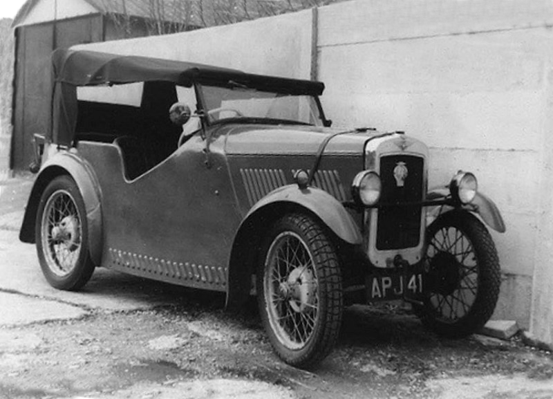

If you want to replicate a 1932 sports body style, how about the AEW Foursome? It has the advantage of using the tall standard radiator shell, and no complicated door structure:
[Image: 158_05_11_17_3_52_18.jpeg]
Or there's the Arrow 4-seater (with doors!):
RE: Sports bodies for a special or replica or travesty (depending on your point of view) - Ian Williams - 13-05-2018
The Arrow body is in my opinion the more attractive and in special form could be built with or without doors, they were Ash framed so possibly a project for Messrs Prior?
