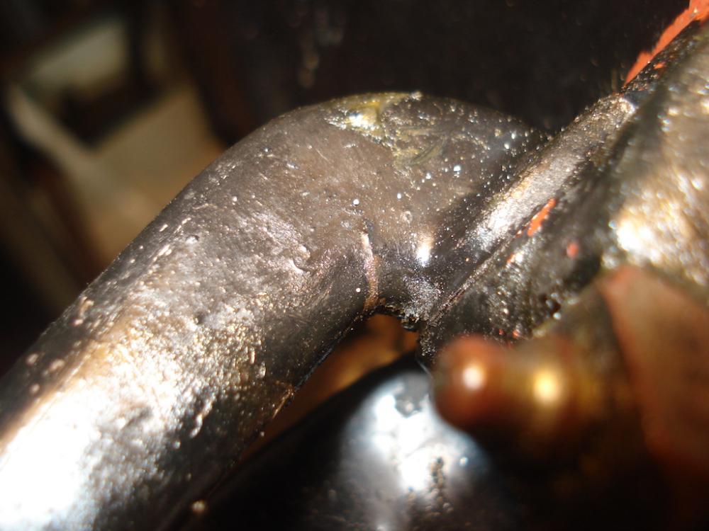

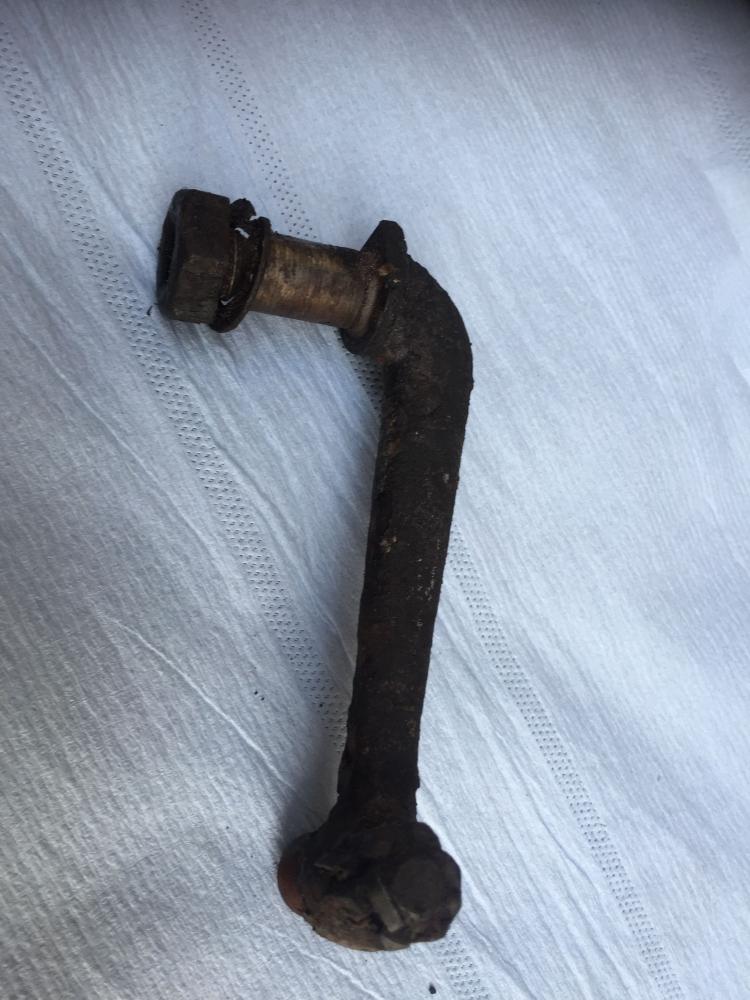

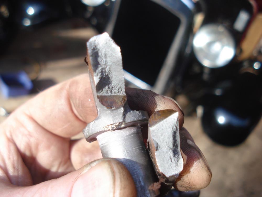

Much has been said about the weekness of Austin 7 steering arm's by believers, non believers, and drama queens alike, some have asked for evidence as to how deeply the cracks go, suspecting that they may be superficial. So I currently have a Chummy in the workshop for a few things, today I removed the front axle to replace the Kingpins and on inspection the steering arm was quite obviously cracked, after taking it off I decided to carry out a very technical destruction test with a copper mallet. Angel
Three heavy blows resulted in this!

Been like it for many years. Its interesting that the crack "stopped" in a straight line. I would have thought it would have been more "arrow head" shape.

The car has been laid up for a good many years and my job is to recommission it, if the crack would look any different had it been in regular use I can't tell you.

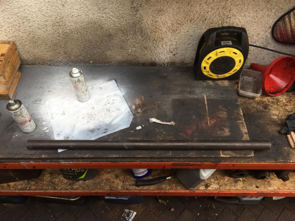

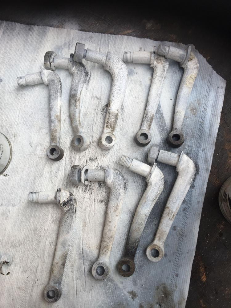

I had to do the same job today.
This has been on a car since 1970 which was used daily up until 1995 and is being reccomissioned so well worth looking at.

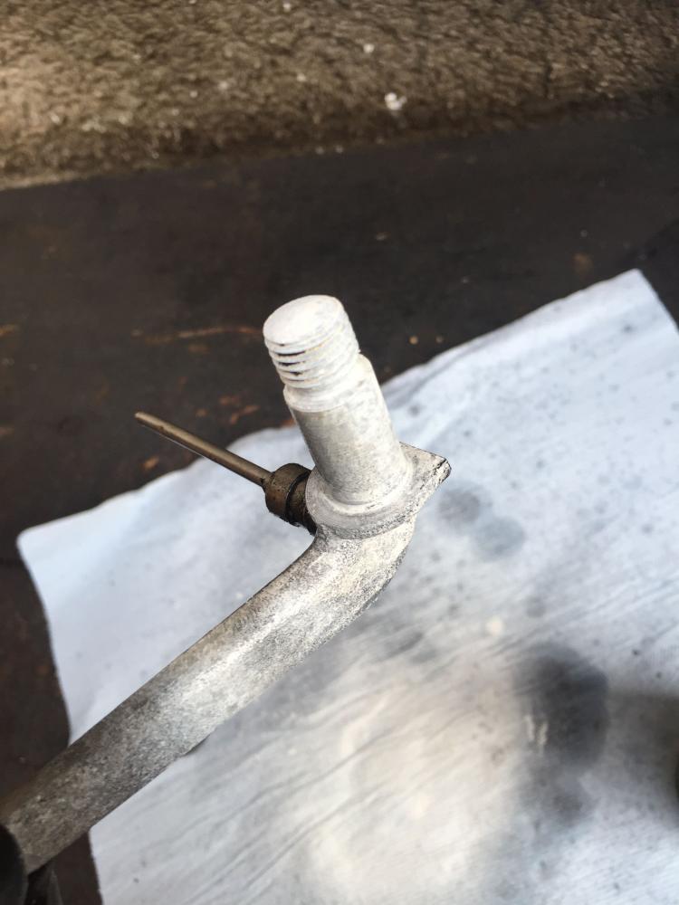

Cleaned and ready for crack test...

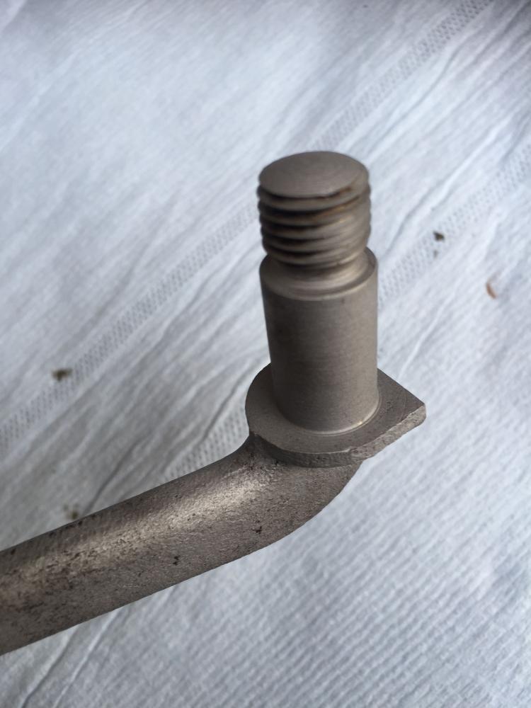

After testing.

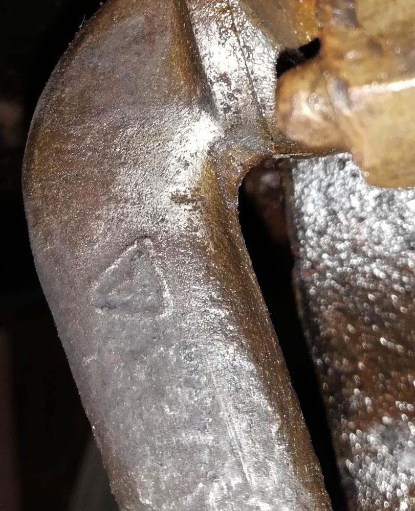

I did a some rods as well, one was cracked...

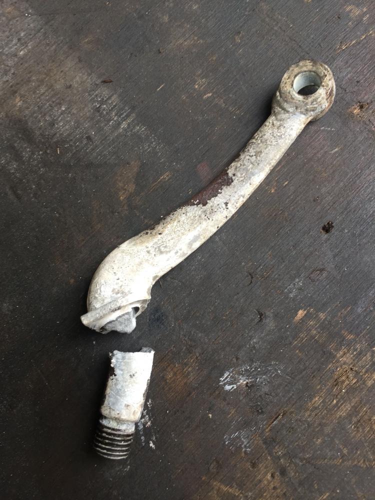

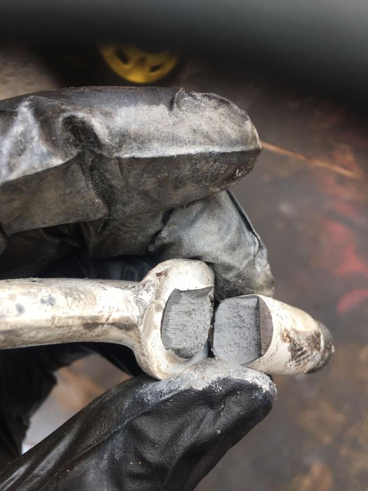

I also tested all these arms, only one was cracked and this was around the shank base not on the inner radius as in Ian’s above.
I did manage to snap it using a 4’ tube, the arm bent first and the with an almighty heave let go slowly.
RE: Broken steering arm - JonE - 08-05-2018
crack testing kit only 18 quid on ebay. I've bought some to try.
what is the little rod thing in your pictures Ruairidh? It must be a magnet or something, but is it a holder?
RE: Broken steering arm - Ruairidh Dunford - 08-05-2018
It is the magnet I use for the crack testing Jon.
