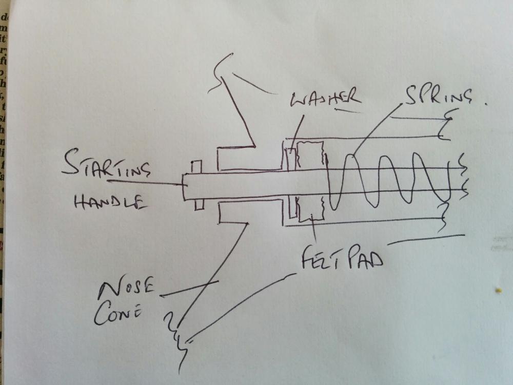

I should clarify my question. How do you stop water and crud getting down the nose cone and into the engine?
My drawing shows my proposed addition of a washer and a felt pad, all that's on the car at present is the starting handle shaft and the spring.

On my 65 the front of the nose cone is just a hole, no thread, no nut, no nothing.  The spring is tensioned directly against the starting handle. Also the cut out in the shaft is in line with the pins, so the handle is parked at 6.00 o'clock or 12.00 o'clock.
RE: Starting handle - Austin in the Shed - 03-05-2018
(03-05-2018, 08:00 PM)Colin Wilks Wrote: Thanks for that Rick.
I think the service journal is misleading.The diagrams show a c1929-31 nosecone which had a 7/8" shaft and short starting handle.Post 1931 they are all as you describe Colin,an 11/16" starting handle shaft and longer staring handle shaft which acts as a bush? in the alum housing.
All the '29 type housings I've seen have a 1/4" location pin in a 1/4" slot at 3 'oclock (Looking from the inside).The later one has a pin through the end with a claw type crank front bolt into the crank.
I don't think any of the later staring handle housings have any provision to keep the muck out,If fact more likely to drain into the sump via the internal drain hole.

My car lived outside for decades and cloth was kept wrapped around the entry.
The later plain nosespieces are a misson to bush. Often the radiator has cut inconveniently into the metal.
Possibly the earllier with brass nut can be turned out for a thin O ring.
RE: Starting handle - Dave Mann - 05-05-2018
I didn't like the gap between the starting handle shaft and the housing allowing all the road dirt and water thrown up by the preceding car to go into our RN engine. I turned the starting handle to 7/8" and bored the housing out and bushed it back to 7/8" , securing the bush with Loctite bearing fit. Do not go less than 7/8" or you can't get the spring in. In hindsight maybe I should have made provision for an O ring seal.
