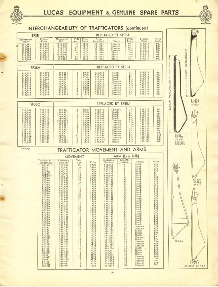

I recently found a 1939 Lucas CAV list 400b which has an interchange list- looks confusing and not sure if it is of much use.
