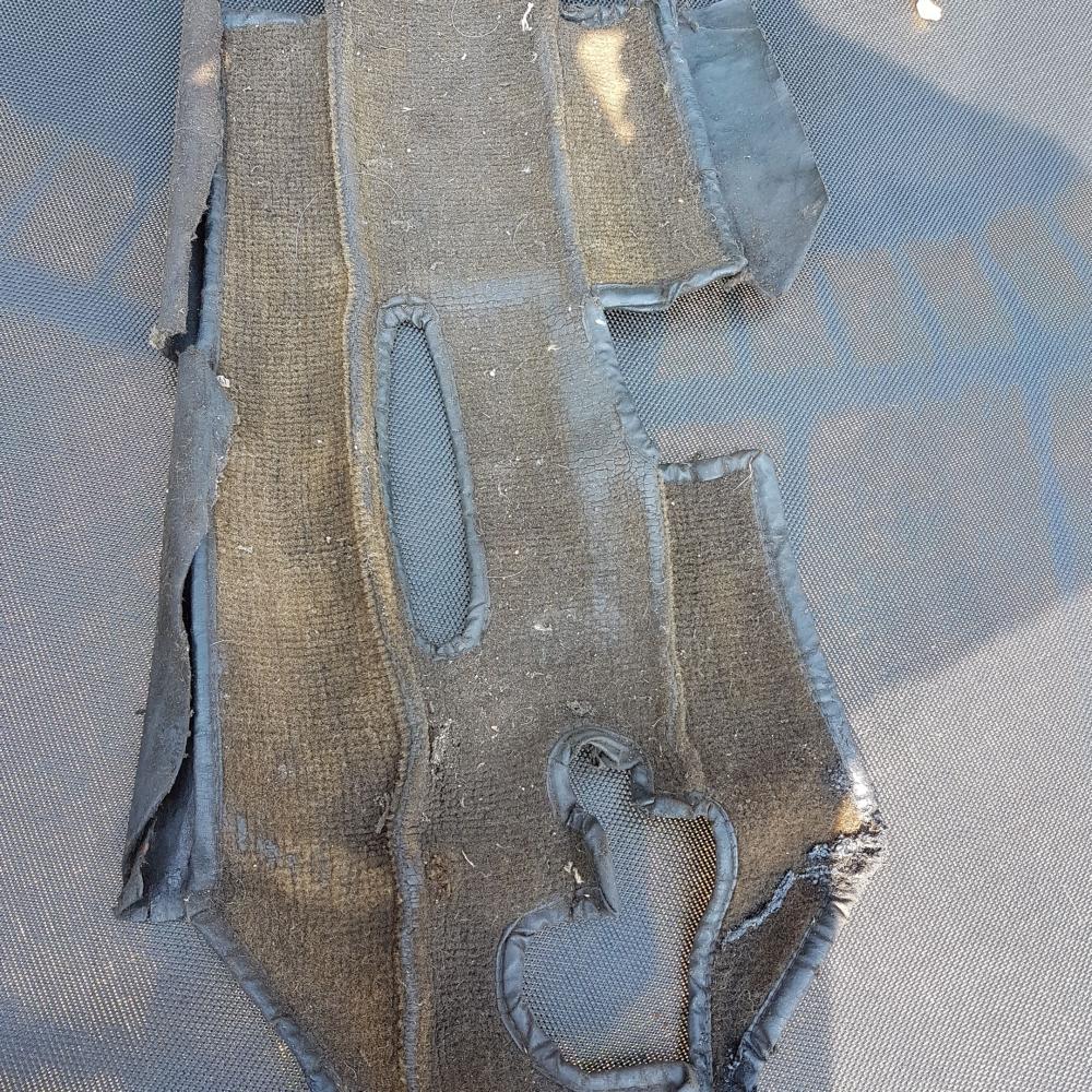

Just lifted the mancky oily carpets off of the tunnel. I am happy that they could go back, but shall I clean, remove oil and grease? Shampoo or carpet cleaner or what have you? Any ideas gratefully received.

just go gently and watch that colour flood back.. but you might want to check for carpet moth first and perhaps make sure any infestation is dead.. there look some suspicious patches there.
I tend to use the suds off the top of what ever concoction you use, with an old toothbrush, just so you keep things as dry as possible...you may want to let it dry off and go over again.
