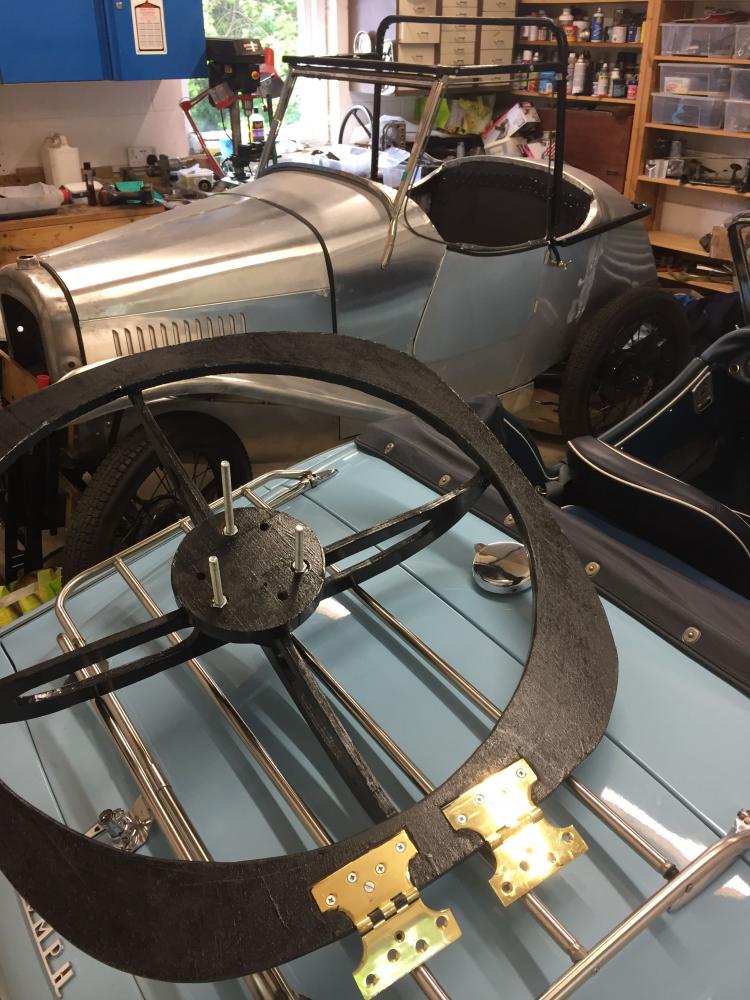

RE: Cup in a Box - resurrected from the old Forum... - Ian Williams - 10-06-2018 Can we have a picture of the boot lid/hinge problem please, how were they fitted originally? RE: Cup in a Box - resurrected from the old Forum... - Ruairidh Dunford - 10-06-2018 The boot is being worked on just now Ian, I am keen to hear how others building similar have solved the hinge. It is a simple affair, just two. Many thanks. RE: Cup in a Box - resurrected from the old Forum... - Ian Williams - 10-06-2018 Presumably they are attached to the alloy skin and you need a backing? That could take the form of a block of shaped wood which I guess is how they were done, or a shaped piece of steel with some threaded inserts riveted inside the skin, you have probably thought of both these which is why I am intrigued by the problem, is it more complicated than I am imagining? RE: Cup in a Box - resurrected from the old Forum... - Ruairidh Dunford - 10-06-2018 They are attached to wood in the tail and the boot lid cover Ian, nothing complicated or fancy whatsoever. There is not really a problem, just tapping for some previous experience. There are a number of Forum users who have built up Cup models and I am keen to know what they used, many thanks. RE: Cup in a Box - resurrected from the old Forum... - Peter Johnson - 11-06-2018 The only photo I have to hand is this one. The hinges are nothing special, although they would be better in stainless. I have drilled and tapped a plate to sit in the back as it is difficult to get a nut and washer into the small space behind. I’ll try to get a better photo later. Peter RE: Cup in a Box - resurrected from the old Forum... - Ruairidh Dunford - 11-06-2018 Thank you Peter, can you remember where you got them please? RE: Cup in a Box - resurrected from the old Forum... - Peter Johnson - 11-06-2018 PM sent! RE: Cup in a Box - resurrected from the old Forum... - AllAlloyCup - 11-06-2018 Hi Ruairidh A pal at the local Men’s Shed sold me these hinges for £10 Which he had leftover from some work on his Church Hall. Very, very solid brass so may plate them Nickel with my home plating outfit. Not original I know but stronger than most. Regards Bill G RE: Cup in a Box - resurrected from the old Forum... - Ruairidh Dunford - 11-06-2018 Thank you Bill. RE: Cup in a Box - resurrected from the old Forum... - Graham Honnor - 11-06-2018 If it's any interest to you, that design is called a Parliament hinge and from memory Screwfix do them in stainless steel for about £15. |
