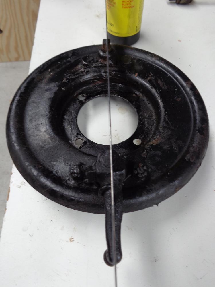

Okay folks, I have dismantled and removed the front backing plates (semi-Girling). I think that I read somewhere that the brake actuators are handed, marked NS and OS. I can't find any markings on these, and the levers are exactly inline with the centre of the hub when in the relaxed state.
Am I missing something here? Again from what I think I read, I understood that the brake actuators were at an angle from the centreline. They are obviously not. Any help appreciated, as always.

RE: Front hubs - falcott - 22-04-2024
(21-04-2024, 07:36 AM)Reckless Rat Wrote: Perhaps the cotter pins securing the levers need turning round. ( from front to back)
The cotter nuts should be to the front.
Drat, I meant to attach a photo and obviously forgot. Anyway here it is to illustrate what I said. The actuator arm is not symmetrical but has a "wave" in it. Is there a way in which the "wave" of the actuator arm should be facing? I know it is difficult to explain. This photo is of the left hand backing plate. Also, the straight-edge is a ruler stood on edge, through the centre of the hub, and the ball of the actuator is in line with the centre (despite the slight discrepancy in the photo).
So RR, if the cotter pin is to the front, does it change the actuator angle? Thanks.

RE: Front hubs - Ruairidh Dunford - 22-04-2024
Your front brake levers should sit forward and front, not straight down as in your photo. Is it still in this position with the pistons, shoes and springs all in place?
Girling cotters are orientated with the nuts towards the centre of the car, front and rear (opposite of Austin brake cotters).
