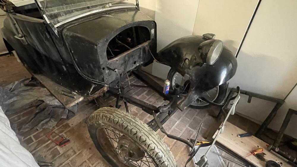

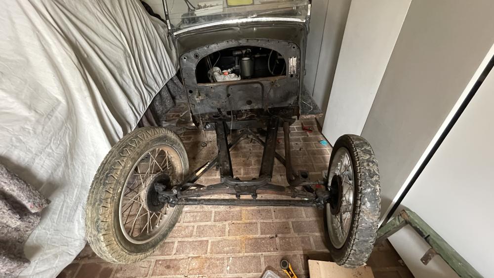

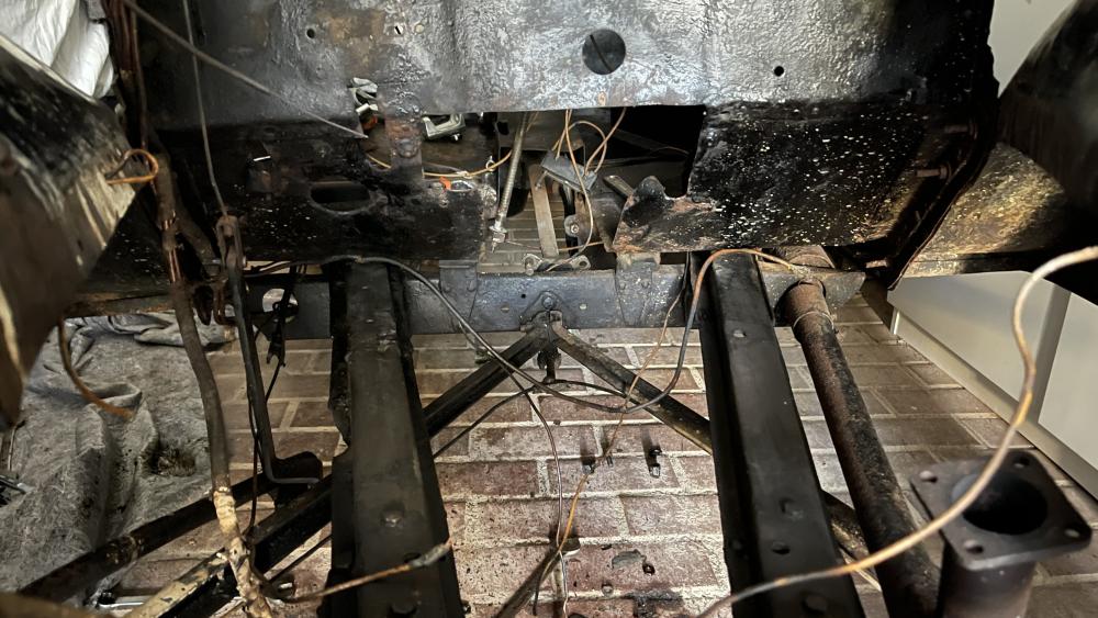

The last few weeks have been quite busy as I have been able to spend more time here, and so I have continued to strip the front of the car and investigate the electrics and other mechanical components.
So, far I have concluded the electrics are beyond repair and clearly a fire hazard!
The gearbox is out, and has either emulsified or no oil inside.

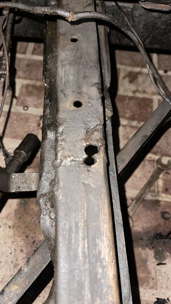

There is a serious problem with the chassis where the steering box mounts. I gather this is a common fault. Brace sections have been found and ordered thanks to David!

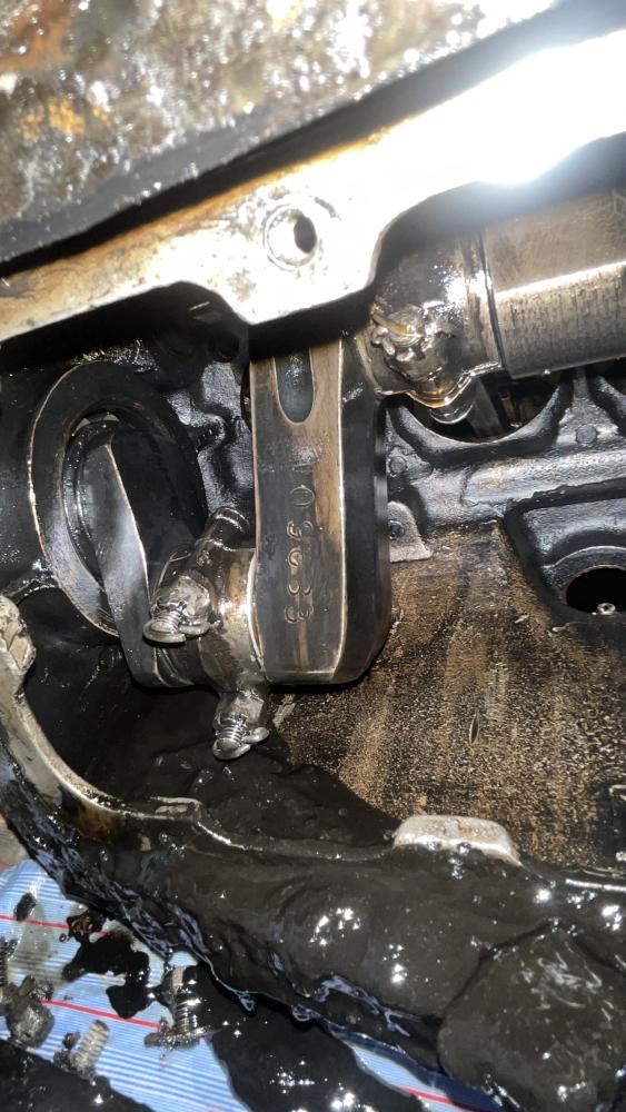

I have not yet plucked up the courage to attack the damage to the chassis, so instead I turned my attention to stripping the engine.
It hasn't really cheered me up though!

I bet you're glad you didn't try to start it! Any metallic bits in there?
RE: Introduction from a New Owner! - Leisureking - 23-07-2023
Haha! Yes, absolutely. There was never going to be a youtube style "will it start" type of ending to this!

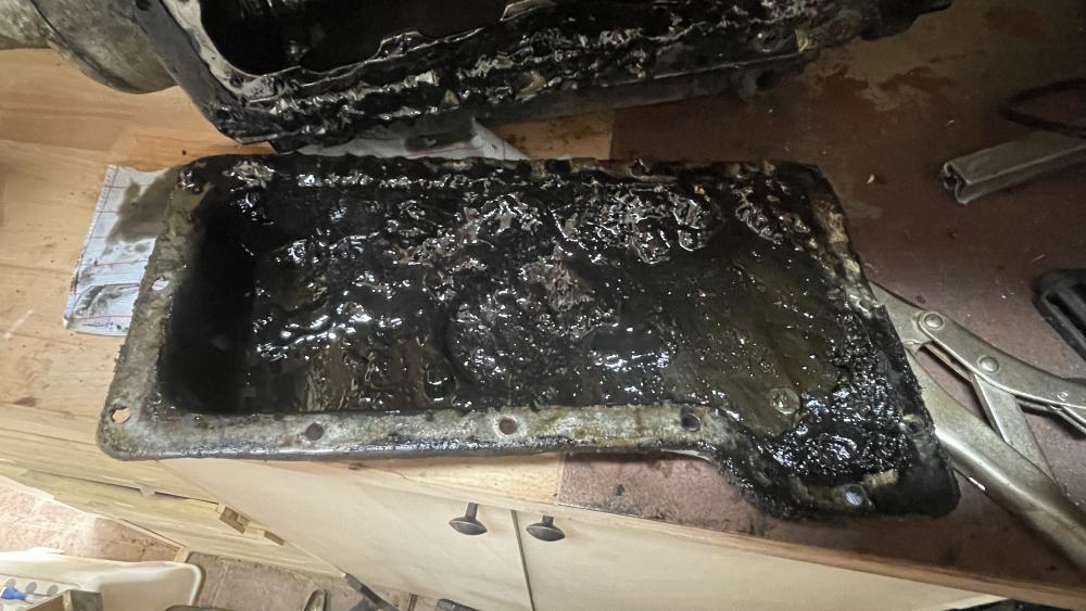

So far, no obvious metallic bits. I am dissolving the crud in some clean oil and will then pass it through a filter to see how bad it is. The saga continues...

Your chassis damage looks much worse than mine (which was just a crack). However the steel Austin used is very weldable.
Good luck

I like the body styling of your car - someone spent a lot of time on that.
Everything you show is fixable.

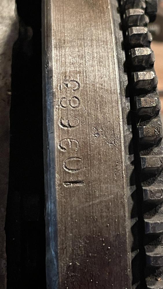

The flywheel and crank are stamped with the engine number, but the pistons appear to be +50 oversized.
P.S. The horrible scraping marks were not made by me! they were revealed by dissolving the carbon with paraffin and carb cleaner.
RE: Introduction from a New Owner! - Tony Griffiths - 24-07-2023
(23-07-2023, 10:47 AM)Leisureking Wrote: Yes, you are absolutely correct. It is April 1930 according to the heritage certificate. For some reason I keep thinking it is ‘31!
That means it's based on the AE. However, the body and wings are different and, unless it's a modified body from something else, it must have cost a small fortune to build. Interesting that the top part of the screen seems to be original to an AE.
