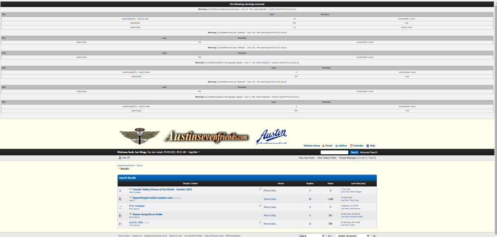

RE: Supercharged coolant system woes - Ian Wegg - 01-10-2022
Me too. It's bizarre that this thread is the only way in ... apologies to the OP for hijacking it!
I can see that there have been a couple of new posts, one yesterday about "Error Messages" and Mike Costigan's picture of the month this morning.
Hopefully, if the admins aren't already aware they will soon notice the lack of activity from the rest of us. Here are some screenshots if it helps...
.png   Ausitn7friends-errors-2.png (Size: 33.85 KB / Downloads: 179)
.png   Ausitn7friends-errors-3.png (Size: 23.05 KB / Downloads: 178)
