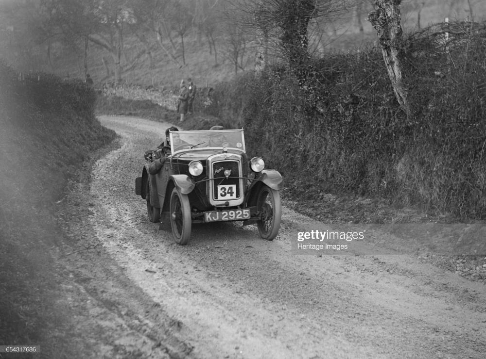

Two 1931 images...
.jpg   austin 1931 7arrow-october.jpg (Size: 29.39 KB / Downloads: 334)

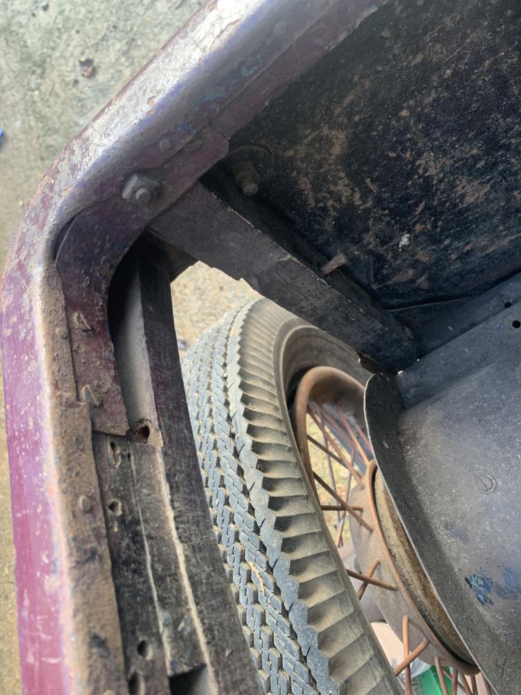

Photo of rear

Photo of rear
Jon
Just noticed from your link, that the fixings for the side screens on top of the doors are the same.

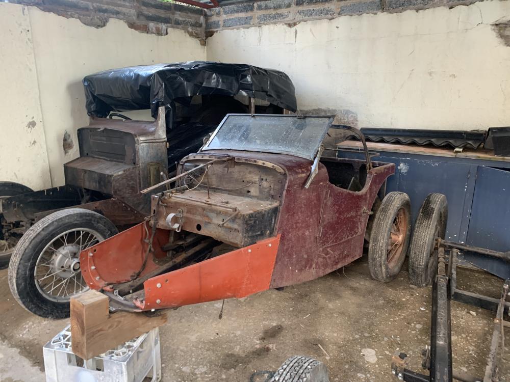

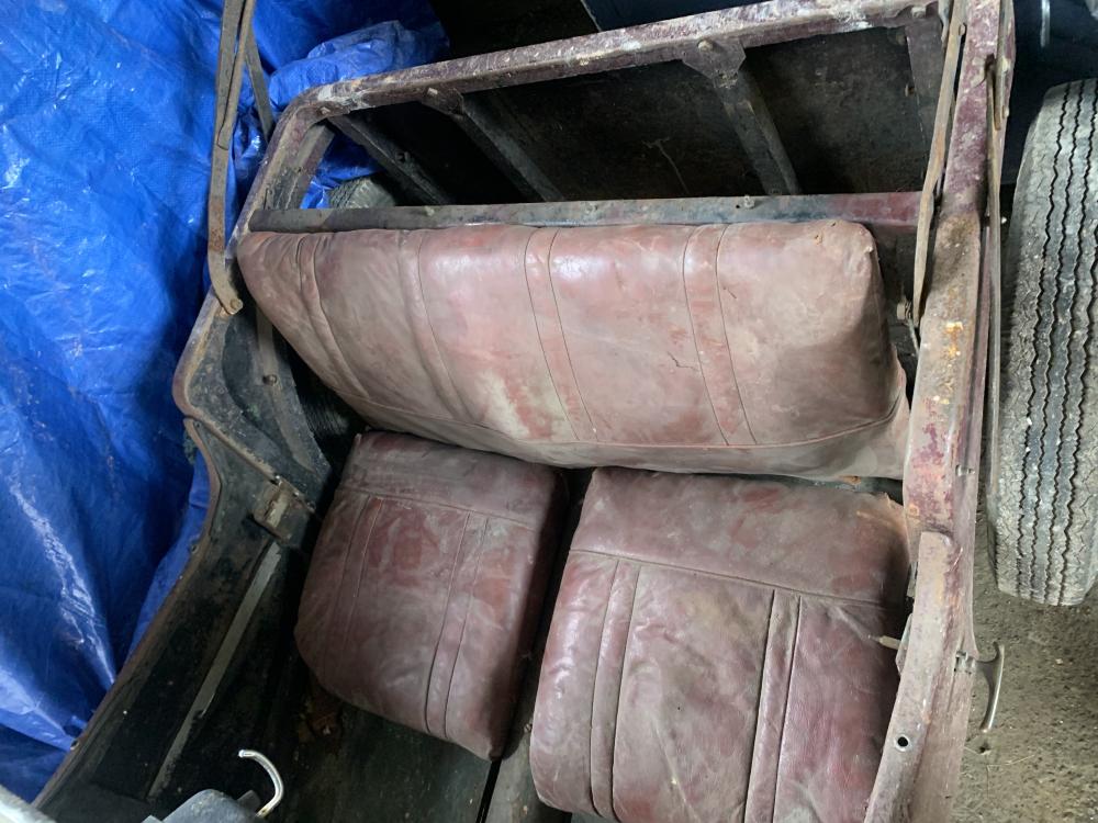

Well I had hoped we might of had a few Arrow front wings lurking amongst the parts, but unfortunately all we seem to have is a pair of cycle wings from its trialing days. I’ve set in place a rad cowl, aluminium bonnet and the seats for the attached pics. Best guess at the moment is that maybe it was at one time an Arrow and then in the 50’s made into a trials car??   It’s certainly not a four seater now.
RE: Looking for info on a 50’s special … Arrow??? - Mike Costigan - 16-02-2022
Looking at the alignment of the bonnet, it looks like it was designed to take the pre-1928 radiator, in which case the Arrow connections are somewhat tenuous.
RE: Looking for info on a 50’s special … Arrow??? - Belinni - 16-02-2022
I bought this car along with a few other cars and many parts, amongst these is an early Chummy style brass radiator shell. It’s possible that it may have been fitted to the car.
I’ve been in touch with Jim Blacklock, he thinks it may have originally been an Arrow Foursome that has had the back end chopped off and rebuilt. Just after the front part of the rear body.
It is described in the chassis register as being a 50’s trials special, so I assume that’s when it all took place, certainly the patina and seats etc would suggest this.
