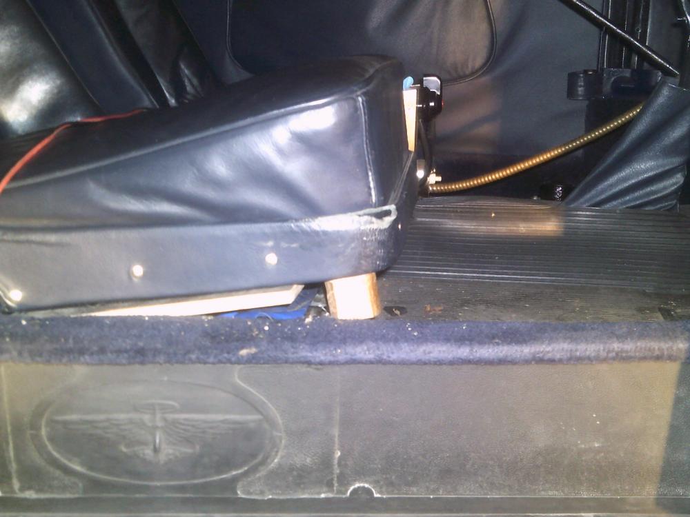

many years ago I got fed up with a numb posterior because only my posterior was supported and not my upper legs so I fitted spacers under the seat front mountings      which had the desired effect. I also realized that they lowered the rear of the seat and my line of sight below the wiper motor.

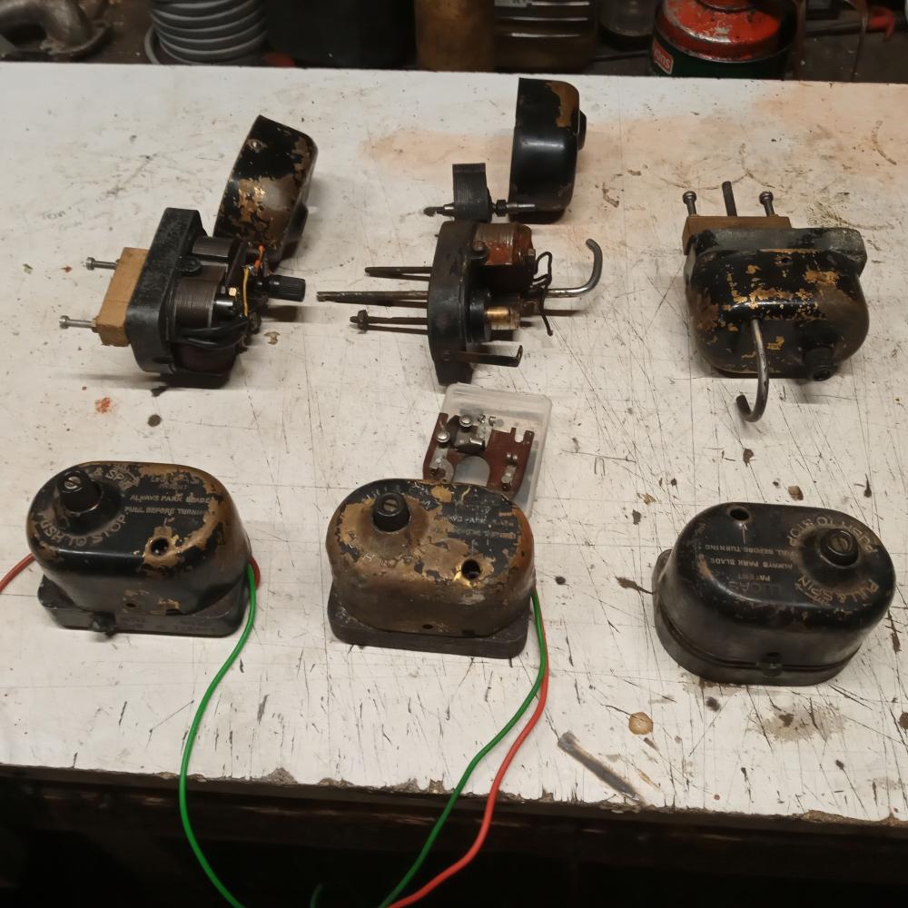

Over the last week or so I've had 6 non operational MT7 pull and spin wiper motors given to me     So far I've brought 4 back to life, the ones with covers on.

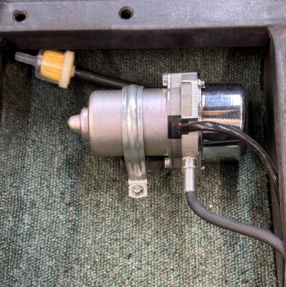

He's just done one for me. Now, where's that eBay advert for a miniature electric vacuum pump?
The two miniature vacuum pumps I tried from eBay were useless and sent back as faulty. Finally, I fitted (under the seat) a rather-too-large pump intended for brake boosting on a modern. It's 12-volt but runs happily on 6 and, on the balls-out setting, the wiper works perfectly. https://www.ebay.co.uk/itm/403706456901  Much the same thing is available from scrap yards of course.
