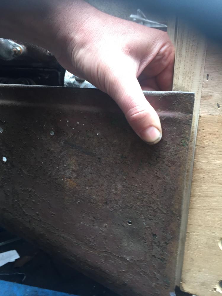

Does this picture, taken after the body was bolted hard down, answer your question Peter?
Everything moves slightly as it comes together, you have to anticipate this when setting up.

RE: Cup in a Box - resurrected from the old Forum... - DavidL - 08-06-2018
Great set of photos. Its the first time I've seen how the body mounts, and interesting to see staples through the ply.
Most of all it answers the question in another thread about how much luggage space. Answer - LOTS. [ relatively Smile ]
What does the screen attach to? (in terms of "what structure is there under the scuttle")

RE: Cup in a Box - resurrected from the old Forum... - Ruairidh Dunford - 09-06-2018
Spare wheel is not compulsory - but eminantly sensible.
Hood and tonneau can be stored on the car, both folded and rolled back with straps.
Tools and spares most definitely, but can be aided by the addition of a second battery box.
Two side screens are overkill but John Wilcox managed, for years, to come camping with his girlfriend over the week long BA7C holiday to North Devon each year with all the above, except a second battery box, in his very original Cup.
Windscreen pillars are supported internally, on this late style body, by two shaped pieces of wood. The earlier design structure is much more complex and I can see why they dumped it!
