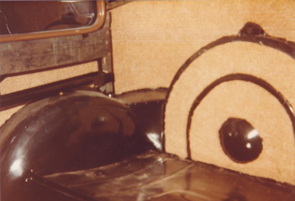

Ian,
I think this is what James is referring to. This was our '37 Ruby. The cardboard was used extensively, as can be seen from the patterns in the remaining paintwork.
Peter.
We replaced it with felt which works very well but is absorbent.

Ian, I see that the information has been kindly already supplied. Is that enough? I'm hoping to take the car to a Southern Classics Meeting at the Bluebell Railway tomorrow and I'll be 'chuffed' in more ways than one if the weather is better! After a period of about 7-10 days of 'scorchio' weather typically it has started pouring here in the South. While checking the car over I was surprised to see the material even on the inside of the metal spare wheel cover. Sadly, it is missing in other places like the floor but noise surprisingly doesn't seem worse for this and understandably the material was the same shape as the rubber mats. It was fairly grubby when I removed it about 30 years ago not long after purchasing the car in 1982. One of the reasons the car is fairly unmolested is that it was displayed in a local BMC Dealership (Hares of Rustington) for the previous at least 25 years, that plus my ownership of 36 years, takes its 'known history' to over 60 years and the car's mileage to just over 107,000 from new.

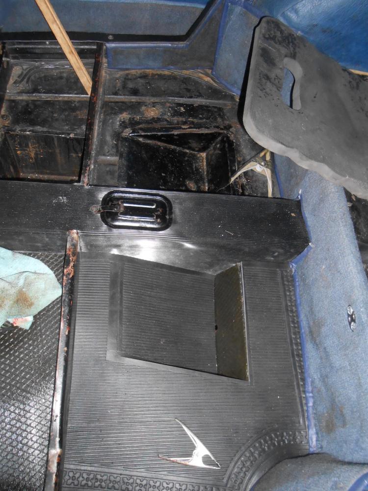

In advance of the Euro Tour last year and while replacing the soft top and sliding head of the RP I fitted quite a lot of sound deadening to try and reduce the noise levels experienced.

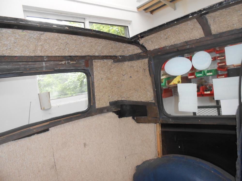

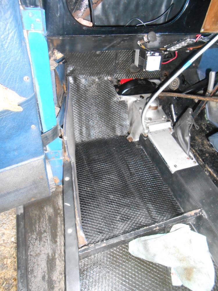

The attached photos show the bitumen backed 1/2" felt I fitted to the roof and sides of the body. I bought a roll of the sound absorbing?/deadening material which has a sticky back and a diamond shape impressed on the outer surface, it is quite heavy, easy to cut and sticks like ..... to a blanket. I fitted new rubber floor covering over the sound deadening. I also fitted it in the under seat boxes, below the back seat and up the bulkhead.
I think the single biggest difference has been the gearbox cover. In the past I have draped several layers of towel or foam backed with thin rubber over the gearbox and noted the improvement. The new cover is made from aluminium, lined with the sticky sound deadening and ribbed rubber over to match the floor covering.
Did we notice much difference? Well it is possible to have a conversation inside the car now, at least if the engine is switched off, otherwise the usual shouting match is the order of the day. Actually we did notice in 3,500 miles being rather less worn at the end of each day, which might be due to reduced decibels. Whatever, I felt better about the car and it is noticeably warmer in very cold weather.
The gearbox cover, which is fixed to the floor with two screws and must be lifted to access the filler plug, must modify with a swing plate
Felt lining to the roof and sides and a piece of carpet behind the rear seat back, which also protects the body when the seat is removed to carry luggage for longer trips

The sticky diamond shape sound deadening, also covers the bulkhead. Note the large grommet fitted to the bulkhead to aid rear core plug replacement and the 240 volt 13 amp inverter is for charging batteries and lap top. I am using a military engine crankcase which is 1.5" longer than standard, so the speedo drive has been rotated 180 degrees to miss the rear cross member.
Floor, under seat tool box and former battery box all treated to sound deadening
