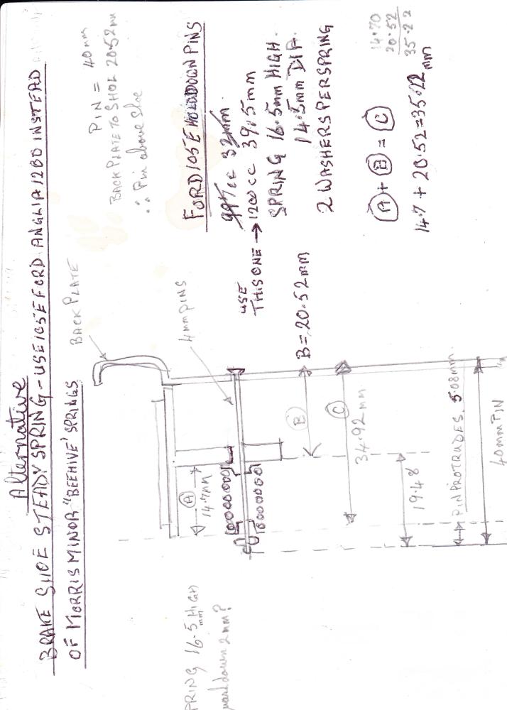

RE: HYDRAULIC BRAKES - Dennis Nicholas - 24-03-2022
Terry and Paul, re the Anglia set up.
Terry's photo shows the spring/washers on the outside of the shoes so pushing shoe to slide on the back plate.
When looking into this I got as far as deciding the 1200 pins were the ones to use because they were 39.5mm long and with the spring being 16.5mm high once the spring was compressed by about 5mm with washers in place the distance between outer washer top and face of shoe web would be 14.5mm.  Did I get these rough workings right?
Pin is 4mm dia.  What size hole did you drill in back plate bearing in mind need to fit the pips on the end through, or did you drill hole and make it slotted?.  Did you countersink the hole so pin end was flush?
I obviously assume there is enough clearance between end of pin and hub.
Attached is the sketch I was working from
Dennis
I just looked back to the discussion of similar nature from when I was fitting back brakes......2018!!!!!!! doesn't time fly.
Sorry to Terry that I had forgotten his valuable information re the holding down pins/springs (though I did make hand scribbled notes that are in my file!......getting  old and memory loss gets worse.  Would still like answers if possible to questions posed above.
  At this rate finishing the rebuild for the centenary meet is looking a bit dodgy.
I think I will use the split pin method for now in the interest of expediency and refine later if proves not so good.
Dennis
RE: HYDRAULIC BRAKES - Terrytuned - 24-03-2022
Dennis a 6mm hole will clear the pips with a light countersink to radius the edge of the hole. Terry
