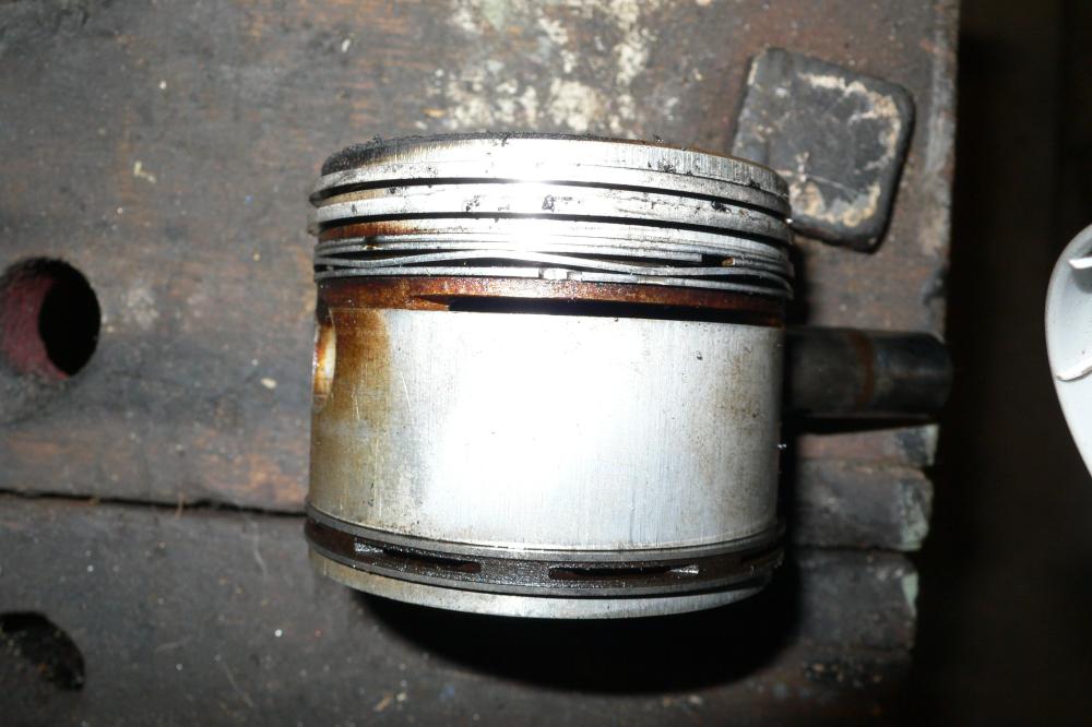

RE: Touring piston oil ring "coiled wire" - David Stepney - 10-11-2021
(10-11-2021, 05:23 PM)JonE Wrote: Thanks for all the discussion. Piston ring springs it is!
So if singly in a set of 4 (as per Seven piston), would one use it in the lowest oil ring position... or the upper position?
I have just been out to the garage to refresh my memory. The mutli-piece oil control ring should be fitted to the upper oil control groove.
The multi-piece ring in the picture is not quite the same as the one you have shown in your earlier photo, but I am sure you get the idea.
(And Hedd, if you see this post,  the image was taken with the Leica D-Lux. A bit better than the old DC20!)
