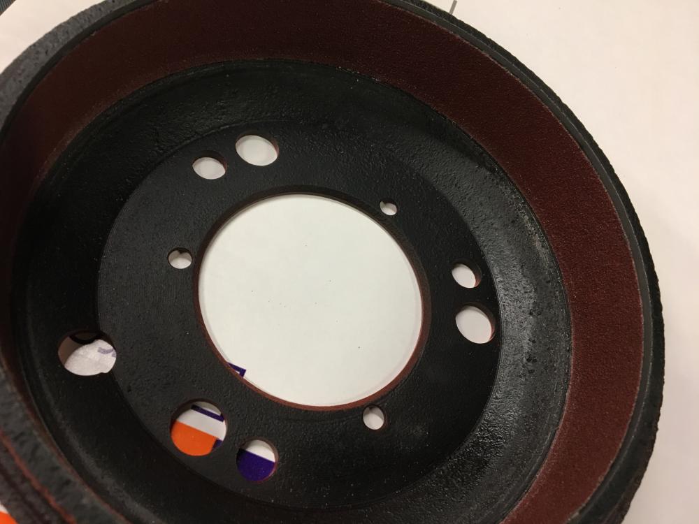

My brake bedding in tool.
Hole in drum is to access adjuster cams. (hydraulics)
Drum skimmed to allow for 3M abrasive thickness.
Lever was made for other job and modified to suit this as well.
Photos should explain.

(28-08-2020, 08:40 AM)Paul N-M Wrote: My brake bedding in tool.
I like that.
Charles
RE: Brake Brake Brake! - Paul N-M - 28-08-2020
I have tried GG lining material and concluded it is probably best suited to rod/cable systems which work at comparatively low pressure. It has quite a high mu but is soft.
Properly bedded in should be ideal for original set ups.
I found that on my hydraulic set up the pressure and temperature generated led to a build up of black gooy brake dust sticking to the shoe which seriously comprimised its performance.
