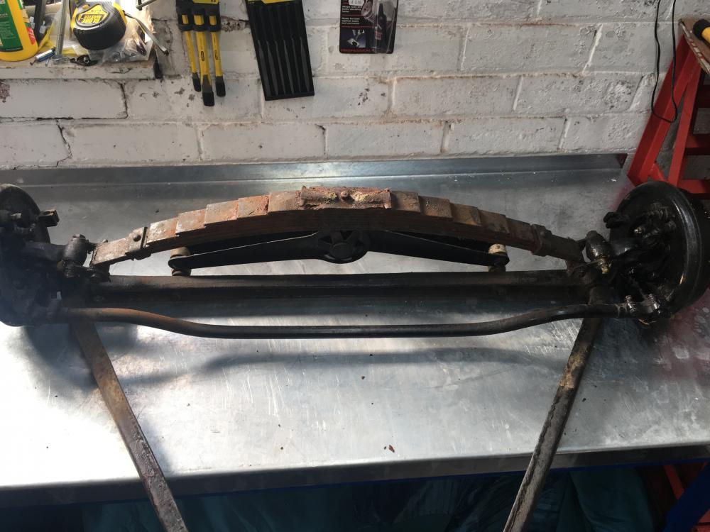

RE: Caster how to add some - Howard Wright - 22-08-2020 Hi Spannerman Just to follow up Malcolm’s question regarding chassis level. If my calculations are correct lowering the rear of the car by about 1 1/2” provides 1 degree of castor. I recently installed a flat front spring and bowed axle for road use but kept the Chummy springs at the back. Measuring the before and after castor showed a 3 degree loss. I’ve now got some flatter rear springs on order! Cheers Howard RE: Caster how to add some - Malcolm Parker - 22-08-2020 The difference that lower rear springs makes was brought home to me when the rear springs on my RL saloon were very tired and only had about 4" camber. The car cornered like a sports car and the steering was very safe feeling. When I put on a new pair of springs with the correct camber the car didn't feel as nice to drive but now they have settled it drives very nicely. RE: Caster how to add some - Rogerfrench - 22-08-2020 Just a thought...if the axle is a 38 the radius arms can't be twisted, can they? RE: Caster how to add some - Alan - 22-08-2020 That’s true RE: Caster how to add some - spannerman - 23-08-2020 Thanks for your help have found if I Slackened the u bolts that hold the Spring I get 4 or 5 degrees of caster So it starting to be the front forging At fault ! Axle is coming off during The week so I can inspect it better,. RE: Caster how to add some - Malcolm Parker - 23-08-2020 It looks as if you need a tapered wedge fitting between the axle and the front chassis forging? The front forging is very unlikely to be bent, it must be the most durable part of the whole car. I have an Austin 7 in the back of my garage that has deteriorated to the point that only the front chassis forging is left! RE: Caster how to add some - Charles P - 23-08-2020 With a late axle if you put a wedge at the front I assume that you'll need to drop the ball joint at the rear, unless you force the radius arms up to meet it! Charles RE: Caster how to add some - spannerman - 23-08-2020 The radius arms have not been loosened At all, only the axle u bolts so it's just the Axle that has twisted to increase the caster So I think its either the forging bent or Spring seat worn ? RE: Caster how to add some - spannerman - 25-08-2020 Can somebody post a picture of the inside Of the front spring mount please. RE: Caster how to add some - Colin Wilks - 25-08-2020 This is the spring on my RP, showing the imprint of the forging in the leather packing piece I found there. The leather shows the shape of the forging quite well. I presume it's the forging you wanted to see but I didn't photograph that I'm afraid. I recall replacing the central bolt with a 5/16" BSF caphead with the head turned down slightly to fit the hole in the nosepiece. I bought some 3mm thick leather to make a new packer, but was advised not to fit it, so mine went back together metal to metal with no apparent problems. |
