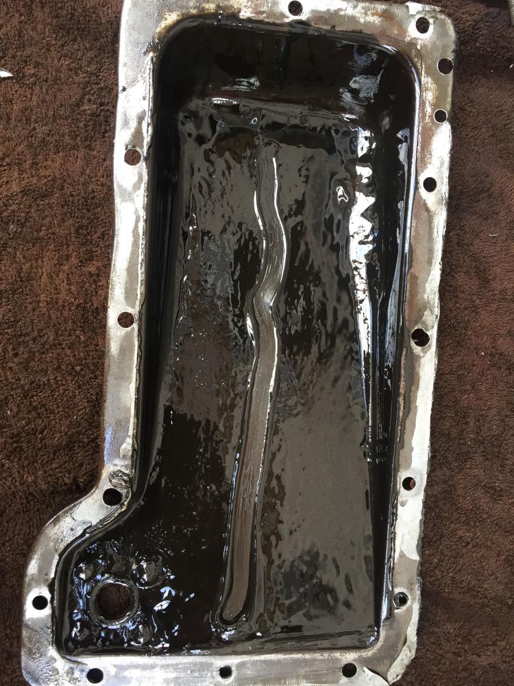

RE: 60’000 miles on cheap supermarket oil... - Ruairidh Dunford - 26-04-2020
I forgot the sump pic.
