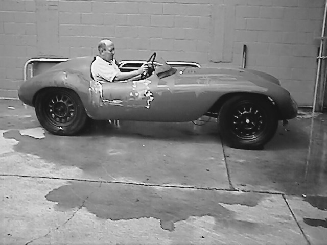

   The body, known as a “Milano”, is a fibreglass copy of either a '57 Testa Rosa or, if you prefer,  an early Jaguar. I have had lots of differing opinions. It was made by JWF Fibreglass in Sydney. Some research highlights the fact that the body was made as a “Coupe” and an open “Sports”. Some 125 bodies were made between 1959 & 1962.
   This body was made to suit a wheelbase of 7 foot 3 inches (Big Seven). There were a couple of sizes. A smaller one to suit the Austin Seven Ruby was known to be available. Opinions are that there are not many existing bodies known to exist. I know of a possible four.

  This totally unknown exercise to me, was carried out by fellow club member Ian Smith, of Mobile Vinyl & Plastic Repairs. The body was in a fairly poor state, cracks, attempted repairs and the doors, which used to swing down, were crudely glassed into place permanently.
   The body was repaired as required and extras were carried out, such as the screen mount modifications. Whilst this was happening, I fabricated the roll bar and mounts, which are bolted to the upswept section of the chassis, rising above the back axle.
