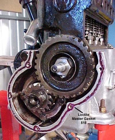

Sealing with 515.jpg (50235 bytes)
Loctite 515 "Master Gasket" is then used to provide the oil seal between the housing and the crankcase.
The 515 sealant is also used to provide the oil seal when reassembling the generator housing.
