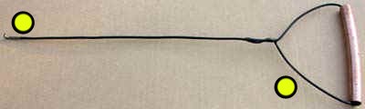

Brake Spring Tool
(Click on the yellow dots for a close-up view)
A short section of copper pipe can be used for the handle and the tip is bent and shaped to suit.

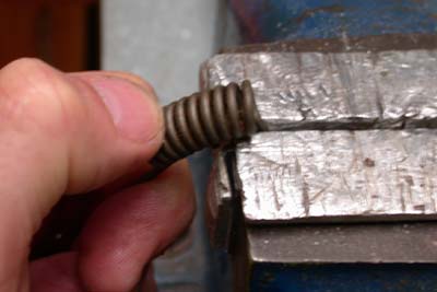

Next, holding one end of the spring in a vice (held by the spring hook), bend the spring to open part of the coil as shown below.

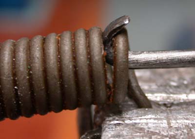

With the spring bent, insert the hooked end of the tool as in the following photograph. Release the spring and remove it form the vice.
