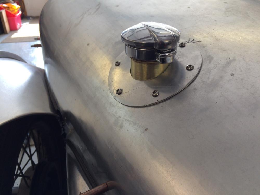

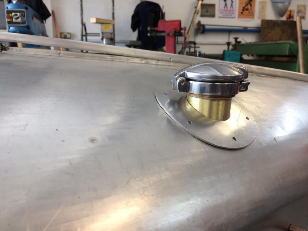

Hi Ian, what are you using to seal between the fuel filler pipe and body? Just a large rubber grommet? Have that same issue on mine. I was thinking of brazing a flat circular disc to the filler tube then using it as a mounting flange with a gasket between it and the body.
Simon
#49
        I used a brass filler tube with a large brass washer silver soldered to it and this penetrates the skin with  a neoprene gasket inboard, an ali escutcheon and rubber washer outboard with 6 S/S button head Allen screws.
If dismantling is required the Monza cap unscrews, the ali escutcheon comes off and the filler neck comes out of the fuel-proof flexible filler tube to the tank. The brass tube showing has been nickel plated since the pic.
#50
Thank's Duncan, was hoping others would have suggestions on this too. Am trying to work out the best thing to do on mine. If the filler goes on the centre line it's tricky since it isn't flat (has a slight peak).It's why I was thinking a shaped flange with the filler tube attached just as you've done.
