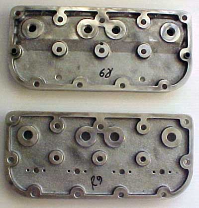

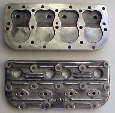

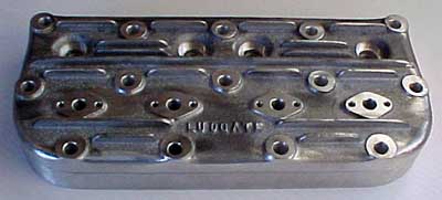

The head was another of Albert's brainchildren which he produced in small numbers for the Seven racing fraternity in the fifties and early sixties. As can be seen from the photos, the design featured sandwich construction, no doubt chosen for ease of casting as it eliminated the need for complicated and expensive cores. It would also have made it easier to maintain correct thickness of material and a clean water space. The combustion chamber was basically late model Seven and enthusiasts often modified the shape to their own requirements. There was also a very neat four branch water manifold which attached to the bosses visible in the photo. The two halves were held together by the normal head studs with a gasket between them, and the water manifold by two quarter inch screws at each connection, coming up through the top half from the water space.
