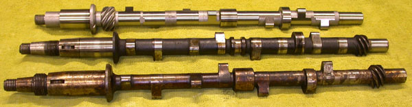

Top - 1940 Reliant Camshaft - Note the different position of the driving gear and the centre bearing area
Middle - Standard Austin Seven Camshaft
Bottom - High Lift Austin Sports Camshaft - Note the roller bearing assembly is replaced by a split bush. The shaft also is larger in diameter in the camshaft gear area. Does anyone know the history of these? Another view of the high lift camshaft

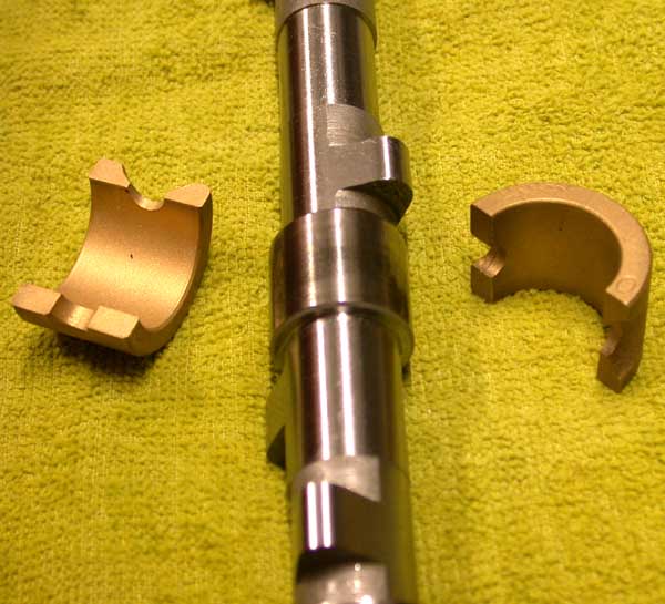

Reliant Camshaft showing the split centre bush assembly

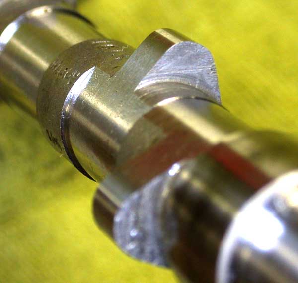

Reliant Camshaft showing the mild sports grind completed
