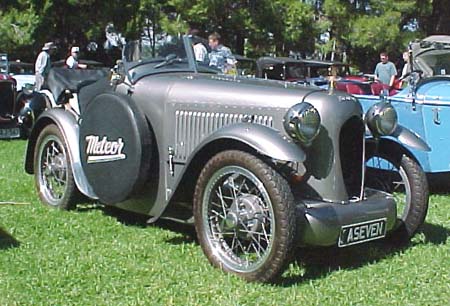

I saw my first Australian designed Austin Seven Meteor and I liked it.
(a rear view is also available)
Photograph by Bruce White

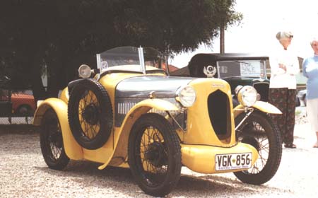

Then I saw this Meteor replica at Austin's Over Australia, in Adelaide, several years ago and decided there and then we needed one!
This sports seven is from Victoria, Australia. The Club in Victoria had in fact made a mould many years ago. The car used to produce the mould was the yellow Meteor shown in the first photograph above. The mould was leant to the South Australian Austin Seven Club and several fibreglass replicas appeared. Mine was one of them. The project has put many of my spare seven bits in the shed to good use and the cost of making the body components from fibreglass makes the project reasonably inexpensive.
